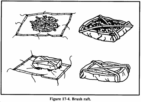

Brush Raft
The brush raft, if properly constructed, will support about 115 kilograms. To construct it, use ponchos, fresh green brush, two small saplings, and rope or vine as follows (Figure 17-4):
  • Push the hood of each poncho to the inner side and tightly tie off the necks using the drawstrings.
  • Attach the ropes or vines at the corner and side grommets of each poncho. Make sure they are long enough to cross to and tie with the others attached at the opposite corner or side.
  • Spread one poncho on the ground with the inner side up. Pile fresh, green brush (no thick branches) on the poncho until the brush stack is about 45 centimeters high. Pull the drawstring up through the center of the brush stack.
  • Make an X-frame from two small saplings and place it on top of the brush stack. Tie the X-frame securely in place with the poncho drawstring.
  • Pile another 45 centimeters of brush on top of the X-frame, then compress the brush slightly.
  • Pull the poncho sides up around the brush and, using the ropes or vines attached to the comer or side grommets, tie them diagonally from comer to corner and from side to side.
  • Spread the second poncho, inner side up, next to the brush bundle.
  • Roll the brush bundle onto the second poncho so that the tied side is down. Tie the second poncho around the brush bundle in the same manner as you tied the first poncho around the brush.
  • Place it in the water with the tied side of the second poncho facing up.

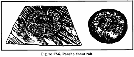

Poncho Donut Raft
Another type of raft is the poncho donut raft. It takes more time to construct than the brush raft or Australian poncho raft, but it is effective. To construct it, use one poncho, small saplings, willow or vines, and rope, bootlaces, or other binding material (Figure 17-6) as follows:
  • Make a framework circle by placing several stakes in the ground that roughly outline an inner and outer circle.
  • Using young saplings, willow, or vines, construct a donut ring within the circles of stakes.
  • Wrap several pieces of cordage around the donut ring about 30 to 60 centimeters apart and tie them securely.
  • Push the poncho's hood to the inner side and tightly tie off the neck using the drawstring.
  • Place the poncho on the ground, inner side up. Place the donut ring on the center of the poncho. Wrap the poncho up and over the donut ring and tie off each grommet on the poncho to the ring.
  • Tie one end of a rope to an empty canteen and the other end to the raft. This rope will help you to tow the raft.

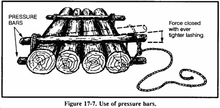

Log Raft
You can make a raft using any dry, dead, standing trees for logs. However, spruce trees found in polar and subpolar regions make the best rafts. A simple method for making a raft is to use pressure bars lashed securely at each end of the raft to hold the logs together (Figure 17-7).
